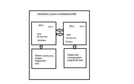

2 years agoTwo qsys system in Cyclone V
hi there, is it possible create a two qsys system (see below system image) with following system components on one fpga? sys1 components: nios ii, onchip mem, spi 3 wire (config as master) sys2 co...

Multi-Nios core processor is possible check this design example link https://www.intel.com/content/www/us/en/support/programmable/support-resources/design-examples/horizontal/exm-multi-nios2-hardware.html
and pdf link http://www.ee.nmt.edu/~erives/554_10/Altera_Multiprocessors.pdf
