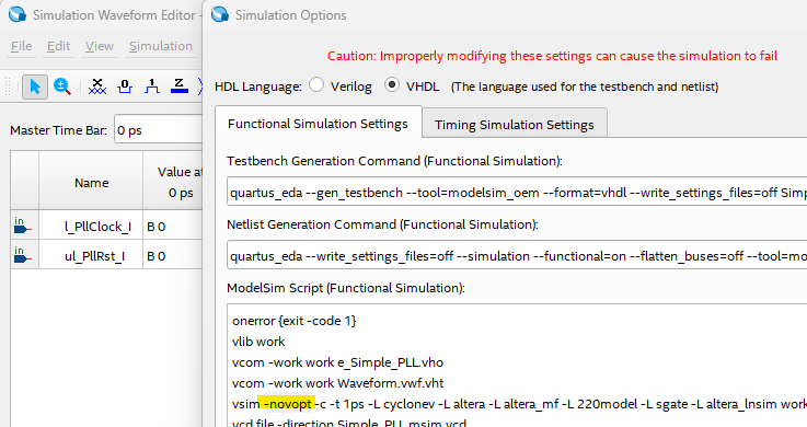

-novopt has been deprecated and you will need to remove it.
Go to Simulation > Simulation Setting, and remove the -novopt in the script.

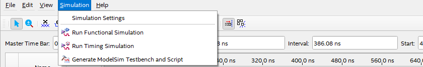

- PJdesigns
Thanks for the reply Richard but where do I find the 'Simulation' folder you mention? I've gone through all of the Install folder directories for both the Quartus_Lite and the Questa but don't see a folder named Simulation. Even in the GUI for the Tool, I can't find anything under the 'Settings' that gets me to a Simulation Settings folder or area.
- RichardT_altera
You can find it the "Simulation Waveform Editor " GUI.
