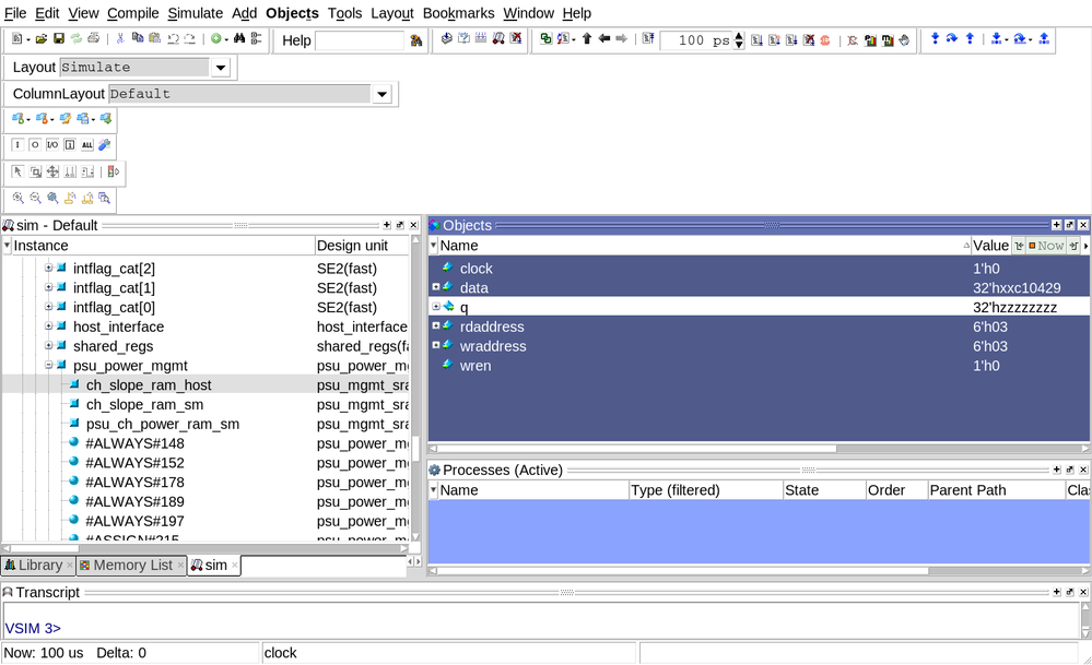

Here is a picture of questa showing the missing wire:
sub_wire0 is missing
This morning I tried removing the entire simulation folder to force Platform Designer to do a complete rebuild and it didn't help.
I know I've done something foolish. I just can't figure out what it is.

- BrianM
I used menu item Add -> Wave -> All Items in region and below and sub_wire0 is not present.
There is clearly some issue with generation of the simulation model, but I can't figure out what it is.
I've tried forcing different kind of SRAM (MRAM, M10K, etc). I've tried changing the bus size.
I've even copied working ram .v and .qip files to these file names, leaving them untouched and it doesn't generate working simulation models.
In the waveform, I can see the write strobe, address and data attempting writes, but the readback always returns as 32'hzzzzzzzz.
I'm not sure what is going wrong.
