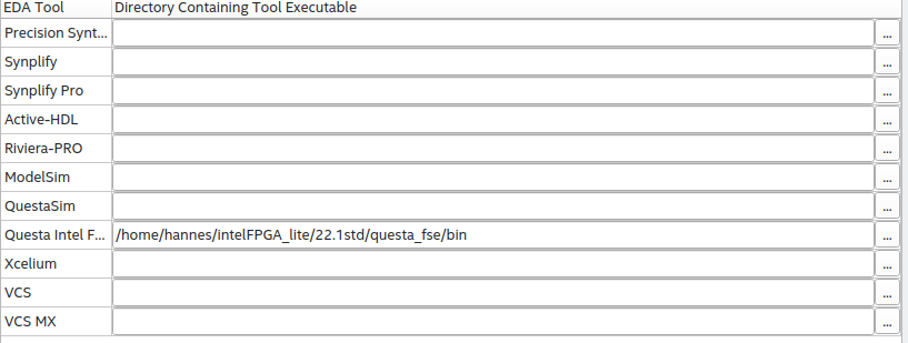

Probably you need to check if the Questa is pointed correctly in Quartus setting in Go to Tools > Options > EDA Tool Options
- HannesDE
thanks for the reply.
The path is set in the options settings see the picture below.
When changing the path to something different i will receive a different error message which says questas could not be found. So i think quartus is finding questas but not the license file
