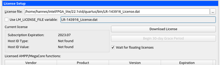

Hello, i currently have problems running Questa to simulate FPGA-Projects My Setup: -Fedora OS Version 38 -Quartus Prime Lite Edition Version 22.1 (Working) -Questa Intel Starter FPGA Edition 64...

I was able to fix it and can now start Questas from Quartus, which is more convenient as it was shown to me like that.
I just deleted the file /QUARTUS_ROOT/linux64/liblzma.so.5 and it started.
There where 3 Versions of this file so maybe the liblzma.so.5 is outdated or something like that and now he is choosing the right version idk.
