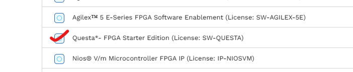

    You need a free license for it: https://www.intel.com/content/www/us/en/docs/programmable/683472/25-3/and-software-license.html
    • Giorgi_Kvernadze's avatar
      Giorgi_Kvernadze
      I did that, but nothing changed.

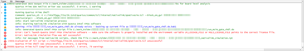

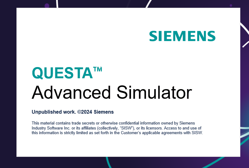

      When trying to launch Questa manually I just get this pop up and it goes away, with nothing happening afterwards.
      And when I set up Quartus to run the simulation automatically after compilation, I get the following messages:

        Based on the messages, it seems like you might not have set up the environment variable correctly.
        Which Quartus/Questa version you are using?
        Starting from version 25.1, Questa Altera FPGA Edition no longer reads the LM_LICENSE_FILE and MGLS_LICENSE_FILE environment variables. Instead, you should use SALT_LICENSE_SERVER. Note that the SALT_LICENSE_FILE mentioned in the user guide is a typo and will not work.
        Please refer to the section titled "Setting Up the Questa*-Intel® FPGA Starter Edition Software License"  in the user guide link provided by sstrell.

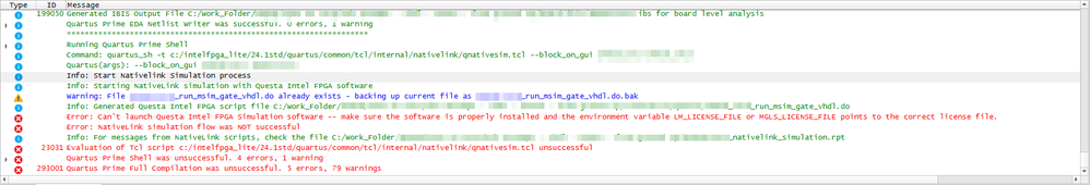

        Latest version simulator needs environment variable SALT_LICENSE_SERVER for fixed license
