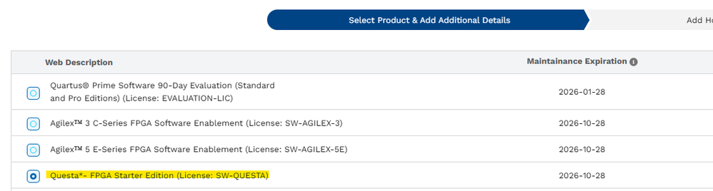

The error mentioned that the license file does not has the "intelqsimstarter" feature.
Please search for "intelqsimstarter" within the .dat license file. If it is not found, you will need to generate a no-cost license from SSLC using the following selection: Questa* – FPGA Starter Edition
*Remember to update the environment variable with the newly generated license file.Regards,
