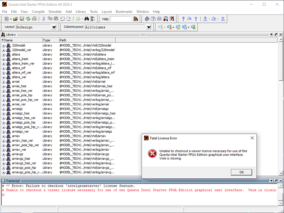

I did that, but nothing changed.
When trying to launch Questa manually I just get this pop up and it goes away, with nothing happening afterwards.

Ok, I fixed a few things, according to what you wrote and it did improve things marginally.
Now It opens, but I soon get this other error and it closes.
One thing to note though is that I have the 24.1 version of the software.
Since that is what is automatically downloaded, when you install Quartus lite.
