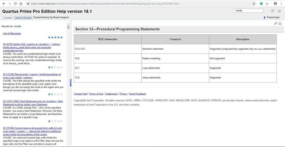

- Vicky1
'case inside' is not supported in Quartus, only 'unique/priority support available on case statements
Quartus text editor recognizes it as a key word (it shows up in blue color).
refer the below attachment,

- Vicky1
SystemVerilog has limited support in Intel Quartus tool, please refer the below link to check supported SystemVerilog features in Quartus tool,
@Branden Allen, Refer the below link for 'mySupport' & Try to keep checking for 'What`s New in Intel Quartus Prime Software'.
