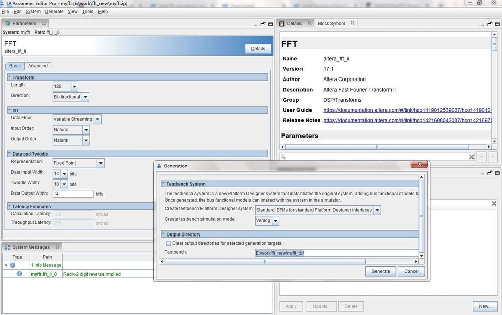

With your suggestion ,I go back to IP setting page and click menu generate->Generate testbench system ,and then
a testbench generation GUI came out , I choosed standard BFM , Verilog MODEL, and output directory is E:/work/fft_new/myfft_tb/
and then click button generate, I can see many files been generated under my nominated location .
I can find the E:\work\fft_new\myfft_tb\myfft_tb\sim\myfft_tb.v , which is the file I mentioned early in last question.

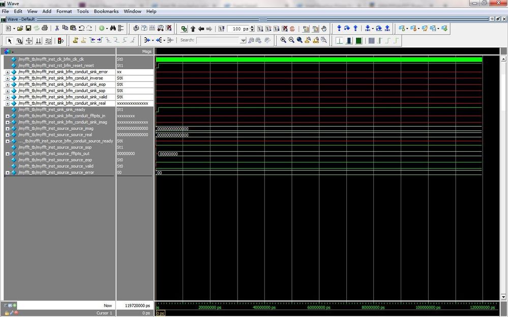

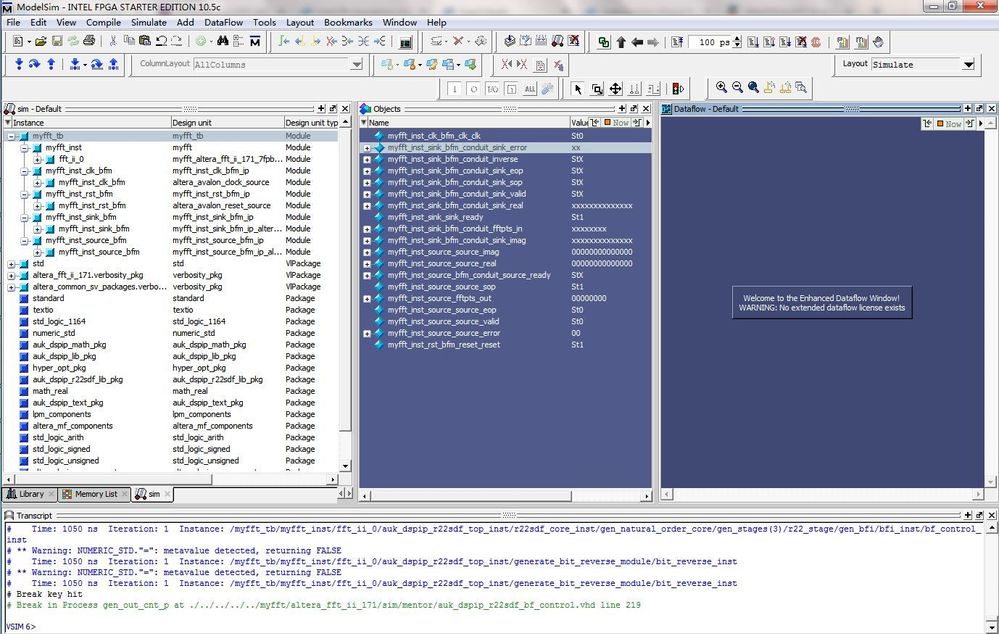

3, manually add top level signals of testbench into waves window , before this step was done by auto-generated tcl ,
4,run –a
5,check the waveform, I can see the clk and rest_n are working as I expected, but BFM part is not working for some reason.
I have not modify any generated files, all of them are generated by tcl.
Id can be performed successfully ,which means device library and ip library have no issue to be compile.
Is there anything wrong? Or I missed out some steps?

I have check the testbench generated by IP tools, I am pretty believe that testbench has installed all the modules
1, clk_bfm ,use to generate clk output
2, _rst_bfm, use to generate reset output
3, sink_bfm, with clk and reset 2 signal inputs and generate all the sink signals feed to fft IP core
4, source_bfm, with clk and reset 2 signal inputs and generate all the source signals for receiving the fft IP result from FFT IP.
I am not sure what kind of stimulus logic does customer need to add into this fully assembled testbench?
from the error information ,I guess it is just a sink and source BFM wrongly behaved.
but clk and rst BFM are working well.
Jim
