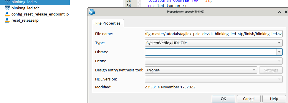

  • ShengN_altera's avatar
    ShengN_altera
    Under Project Navigator Files section, right-click -> Properties -> Specify library
    • wa_itd's avatar
      wa_itd
      Thank you, however my custom component, when instantiated in Platform Designer, is an IP core. So, I think I am unable to change the library for individual files within an IP core (but I can change the library which the entire IP core is compiled into).
      So I might have to think of some kind of workaround.
