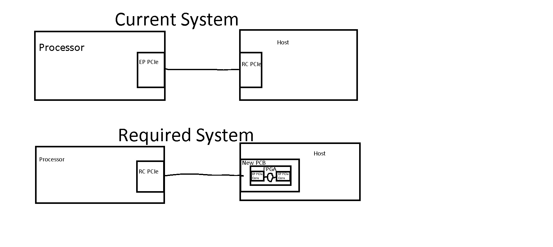

  • OLevy1's avatar
    OLevy1
    attached.
    i hope it will make the problem clearer.
    as you can see in the 'Current System' drawing, the problem is that each time the Processor is rebooting, the Host must be rebooted as well so it will initiate Enumeration process and map the Processor EP PCIe to its devices.
    Oren
