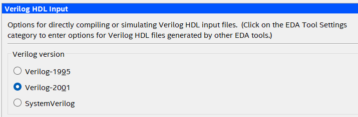

Sometimes it is unavoidable to use "+ :" and "- :" for dynamic interception of fixed bit width. That's when I hit a standstill...So should I set up Quartus to support "+ :"?
In fact, I have selected the Verilog version as Verilog-2001:I would be grateful if you could give me your advice!
- RichardT_altera
Now that I check closely, I believe there is some weird behavior happening behind the compilation. (could be a bug)
I saw the Error (293007) occur with Quartus Standard 22.1 if using insufficient memory. When allocated a larger memory, it took me ~16m47s to finish the Analysis & Synthesis (using the +: indexed part-select) as compared to ~1m30s using other design. (without +: )
If I use Quartus Pro 22.4, both designs compiled successfully in 25 seconds. So something must have gone wrong with standard version.
I will file a case to the engineering team to investigate on this.
Richard Tan
