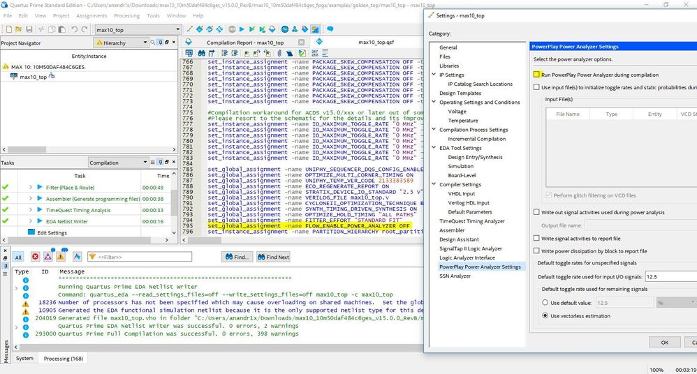

- AnandRaj_S_Intel
I have checked with Quartus 17.0 STD and 18.1 STD run power Analyzer during compilation option is NOT Grayed Out.
Can you delete db and incremental_db folder and add set_global_assignment -name FLOW_ENABLE_POWER_ANALYZER OFF line in your .qsf file and try.
Try by creating new project.
If possible can you share your design let me try from my side.

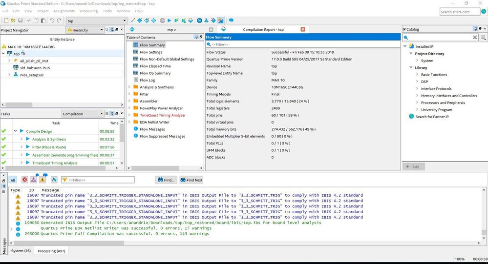

- AnandRaj_S_Intel
Hi Najunda,
Would it be an issue with My licence ?
No.
By checking i found that
- In MAX 10 SA/SC family device the run power Analyzer during compilation option is Grayed Out (meaning always enabled).
- And also i can compile the project successfully using Quartus STD 17.0,17.1 &18.1.
