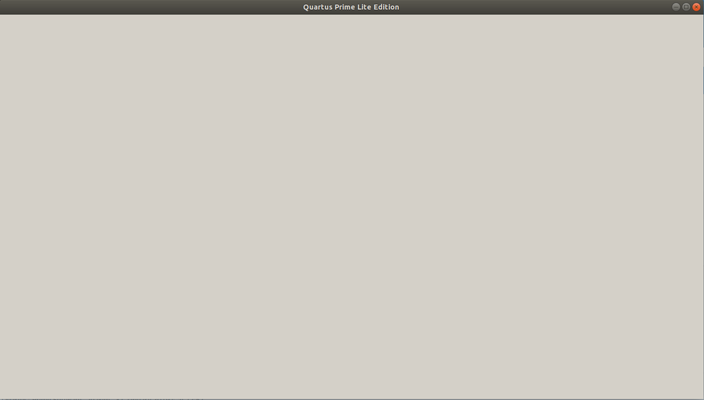

Blank window when running Quartus Prime Lite in sudo mode Ubuntu 18
Hello. When i'm running Quartus Prime Lite in sudo mode i see nothing but blank screen.
I'm running Quartus with sudo because without it Quartus stucks when generates any IP.
I tried 17.1 and 18.1 Quartus versions with the same result. I didn't have that problem on Ubuntu 16.

I checked all libraries and it is all good. I actually can run Quartus normally. But with sudo i got this problems. Maybe there is something wrong with environmental variables?

Yes.. seems like I was able to see the same.. will get back to you on this.. also, can you just use it normally?- MAlek2
Yes. I can run it normally but it stuck when generates IP instances

I've checked environment variables and they are different. Also in normal mode i have much more variables than under sudo. I tried to copy some of them but with no success.

This doesn't work for me, unfortunately. My Quartus stucks at any try to edit or create PLL, FIFO, etc. Running without sudo is not an option.
