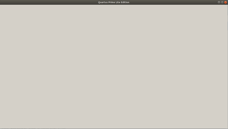

7 years agoBlank window when running Quartus Prime Lite in sudo mode Ubuntu 18
Hello. When i'm running Quartus Prime Lite in sudo mode i see nothing but blank screen. I'm running Quartus with sudo because without it Quartus stucks when generates any IP. I tried 17.1 and ...

as mention, from my side, I just dont use the su. I also face stuck issue when try to edit the megawizard. It was resolve by https://www.intel.com/content/www/us/en/programmable/support/support-resources/knowledge-base/tools/2018/why-does-the-megawizard-got-hang-.html

7 years agoHi,
Can you make sure all the library below had been installed in your Ubuntu?
libc6:i386, libncurses5:i386, libxtst6:i386, libxft2:i386, libc6:i386, libncurses5:i386, libstdc++6:i386, libc6-dev-i386
libxft2, lib32z1, lib32ncurses5, lib32bz2-1.0, libpng12
Extra for ubuntu 18.04: libqt5xml5, liblzma-dev
Also extra for ubuntu 18, libpng12 is no longer available via the apt-get method, download and install libpng12 from here: https://packages.ubuntu.com/xenial/amd64/libpng12-0/download
