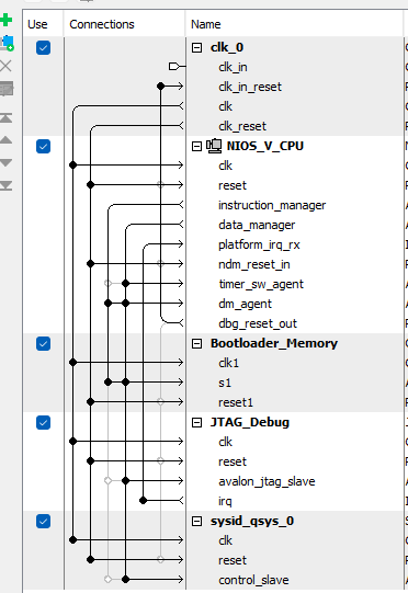

Nios-V on Cyclone IV
Hi all
Trying to get a NÌOS-V running on Cyclone IV using, just the basics. Using Quartus 25.1.
Just as a test I added just the neccessary components and the sysid as shows in the picture below.
Quartus project was compiled without any errors.
Moving on to the application, created a bsp with the sopcinfo file created by Quartus using the command : niosv-bsp --create --sopcinfo=iwis_top.sopcinfo --type=hal software/bsp/settings.bsp
Then created the application using the command : niosv-app --bsp-dir=software/bsp --app-dir=software/app --srcs=software/app
The application compiles with "empty" main file, but if I try to add system.h and altera_avalon_sysid_qsys to use alt_avalon_sysid_qsys_test() it failes with error "Unknown reference to alt_avalon_sysid_qsys_test".
Should not this work right right out of the box ?

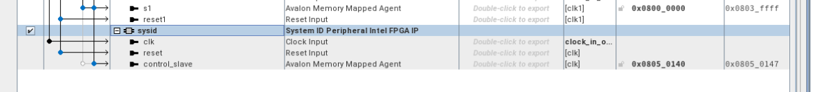

  • Hi ove
    I managed to reproduce the issue on my end.
    It seems like this is a valid issue on the driver side to cause the error you are facing.
    A workaround currently is to limit the naming of the SystemID IP to "sysid".
    Could you possible to try that and see if it solves the issue?
