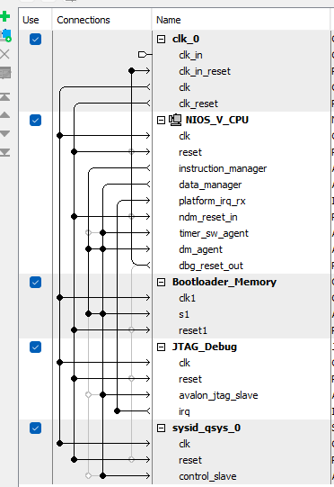

Nios-V on Cyclone IV
- 7 months ago
Hi ove
I managed to reproduce the issue on my end.
It seems like this is a valid issue on the driver side to cause the error you are facing.
A workaround currently is to limit the naming of the SystemID IP to "sysid".
Could you possible to try that and see if it solves the issue?

- ove7 months ago
I already did, but still compiles with "Unknown reference to alt_avalon_sysid_qsys_test"

Hi ove
- ove7 months ago
Nice that worked, can now use the sysid from the firmware
Thanks for the quick assistance.
