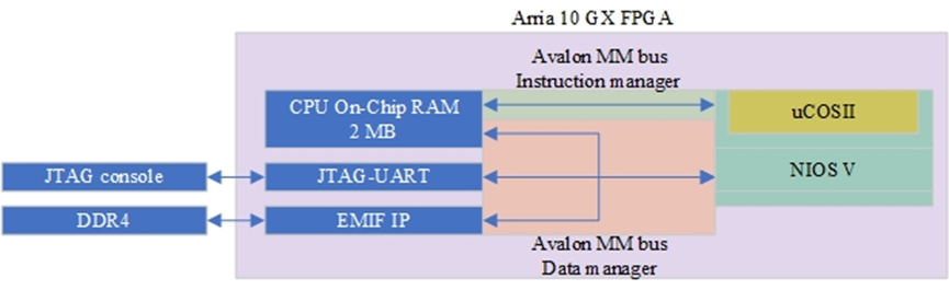

We are currently conducting tests using Arria 10 GX EVB.
However, we have encountered an issue where NIOS V controlling DDR4 through EMIF IP results in a failure when attempting dynamic memory allocation in the software.
Strangely, this issue is resolved when we remove EMIF IP from the system.
Our system's diagram is attached for reference.
Attached is the project file used for testing.
Any guidance or suggestions would be greatly appreciated. Thank you!
Additionally, the initial problem arose from our attempt to add EMIF IP control for DDR4 based on Intel Simple Socket Server example. However, upon debugging, we found that the issue actually occurred during the initial dynamic memory allocation, causing subsequent execution to fail due to pointer unavailability, resulting in an "ethernet initial fail" message on the JTAG-UART terminal.

I took a look at your project it seems like you did not connect the Nios to boot from the EMIF.
Could you try connecting the data and instruction manager of the NiosV to the EMIF controller and switching the reset vector to the EMIF?
