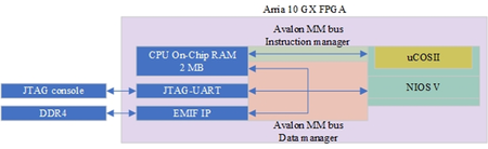

We are currently conducting tests using Arria 10 GX EVB. However, we have encountered an issue where NIOS V controlling DDR4 through EMIF IP results in a failure when attempting dynamic memory alloc...

I took a look at your project it seems like you did not connect the Nios to boot from the EMIF.
Could you try connecting the data and instruction manager of the NiosV to the EMIF controller and switching the reset vector to the EMIF?
