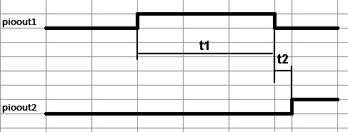

I debugged this code and it works perfectly.
My project became more complicated and I had to use uC/OS-II.
This part of code is very simple and has no changes but it works very strange. Duration of strobe became about 30 ms!
After some manipulation with code I found out that functions of setting timer on are very slow.
I put line A between lines C and D. It makes duration of strobe about 16 ms.
why simple register’s writing become slow? what should i do to make it working faster?
