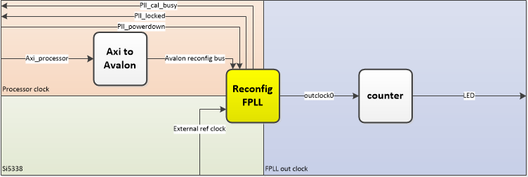

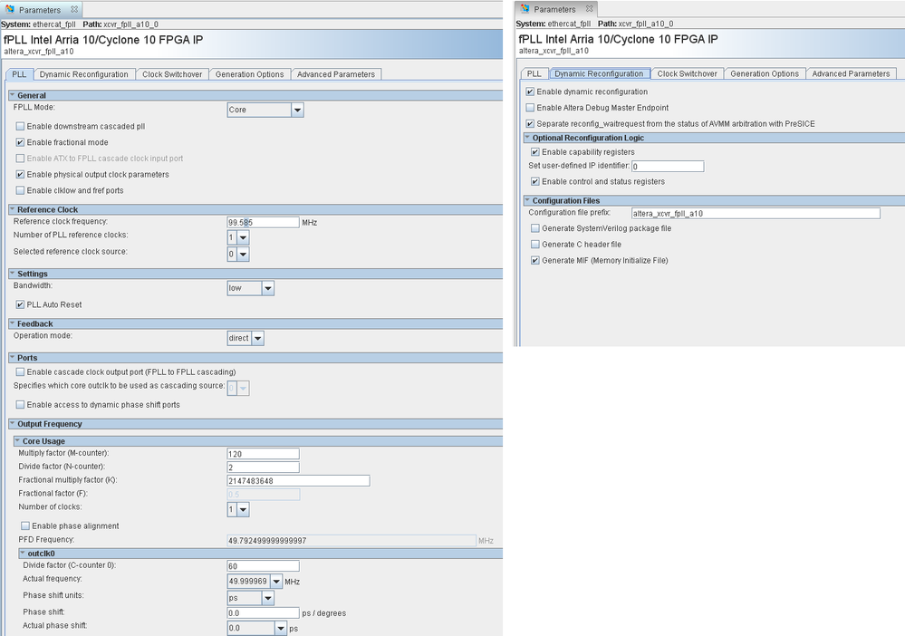

    We use the FPLL in core mode as we want to use it as a core clock source. I included a screenshot of the settings I used, and attached a zip file of the fPLL IP.
    We convert the AXI bus from the Arria 10 hardware processor to Avalon and map it's range to the memory. The 'pll_powerdown', 'pll_locked' and 'pll_cal_busy' signals are connected to registers in the memory range of AXI bus.
    The 'pll_refclk0' is generated from a SI5338 clock generator IC, which is also configured by the processor at boot up. It is set up to generate a 99.585 MHz clock.
    Currently, the output 'outclk0' of FPLL is connected to a counter, that toggles an LED every 5000000 clock cycles.
