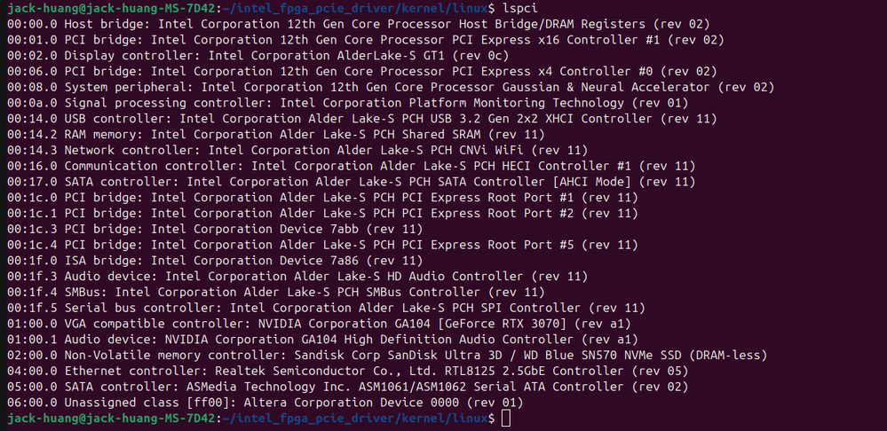

Quartus v24.3 (working version):
  • lspci: shows FPGA on 06:00.0
  • Computer can read PCIe configurations

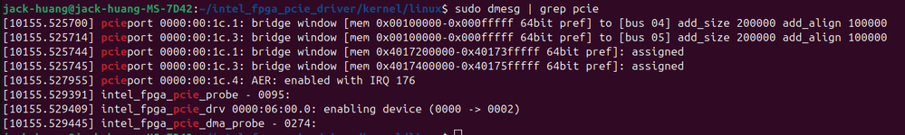

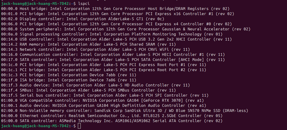

Quartus v24.3.1:
  • lspci doesn't detect the FPGA

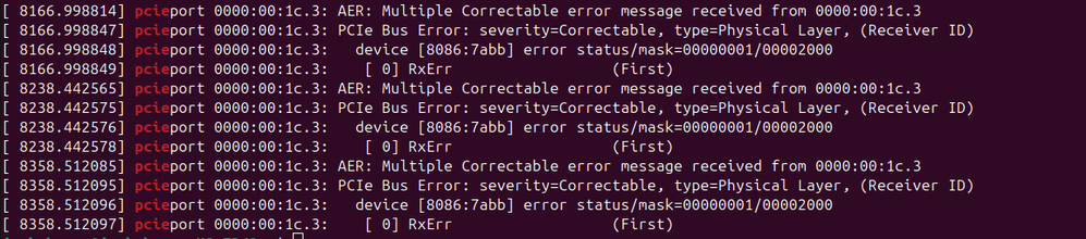

  • sudo dmesg | grep pcie shows errors from the FPGA PCIe port to the PCIe bus
