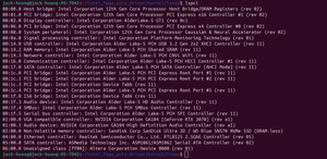

Hi all, I installed Quartus v24.3.1 to test the new SSGDMA changes and enable DMA on our FPGA. However, I couldn’t test the changes in hardware because the new Quartus version seems to have broken t...

Hi Jack,
I created a PCIe Gen3x4 PIO example design in Q24.3 then upgraded it to Q24.3.1 without any change. Before full compilation, clicked "Generate HDL" in qsys to make sure nothing wrong. After these, my ubuntu host was able to see the FPGA PCIe.

Jack_H
1 year agoHi RongYuan,
I was using the PCIE PIO Design example when testing above. It was working in hardware in 24.3 but not working now in 24.3.1.
