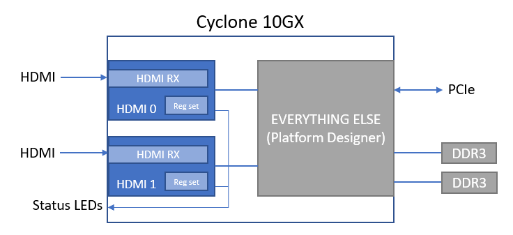

I now have a new situation. I was, after an extended battle, able to get the HDMI RX design working. This design consisted purely of two HDMI RX channels running in a Cyclone 10GX. The design worked on both the Cyclone 10GX dev board, as well as our own prototype hardware.

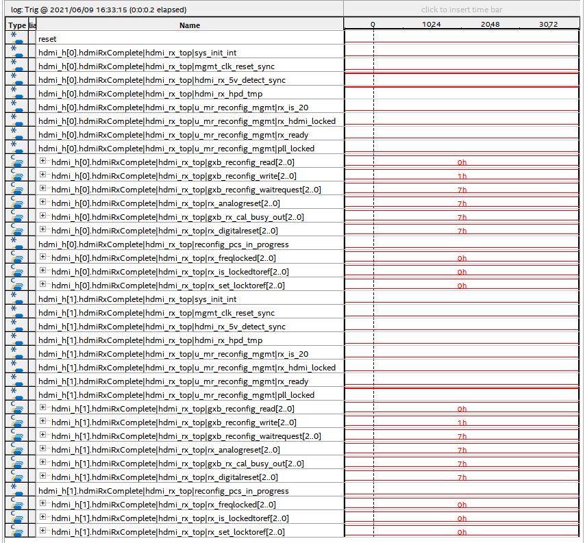

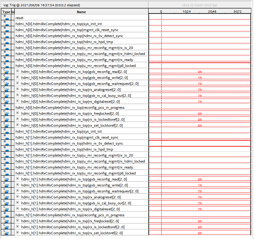

When I incorporate those same HDMI receivers into my full design, running on the same hardware, the transceivers no longer work: they appear to be stuck in calibration again.
The HDMI RX code used is identical between the two designs (it is, literally, the same code, shared between the two quartus projects.) As far as I can tell, all the connectivity between the pins and the HDMI blocks (clocks, resets, and serial connections) are exactly the same between the two designs.
So again: two designs, both incorporating identical HDMI RX blocks connected to the same pins, running on the same hardware: one works, one doesn't. And once again I have no idea how to determine why calibration is not finishing in the GXB block.
In the previous thread, you suggested I work with the GXB example design to see if I can get it working on my hardware. We are past that now; I've had the HDMI working.
Given known working hardware, what should I look at? I feel like there must be a difference between my two projects, but I've checked through them about a thousand times and haven't come up with anything.
