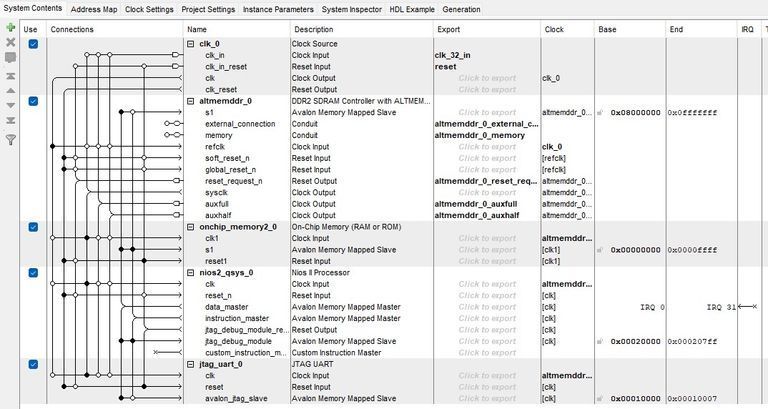

I am trying to create a memory test program for an old mass produced product. The FPGA is Cyclone IV EP4CGX50. I am trying to use ALTMEMPHY IP because this is what was used in the product and it has DDR2 configurations I need to use so I directly copy them since they already works.
First, I download the .sof using Quartus programmer. Then when I try to download Hello World Small or Mem Test Small this is the error I am getting.
As far as I can see on the forum. This is an error one gets when the Nios is already in reset. So here is my top module and qsys configurations to see if I am doing anything wrong.
Simply, all I want to do is to create a memtest using altmemphy IP for DDR2. There must definitely be some people who are already experienced with this stuff.

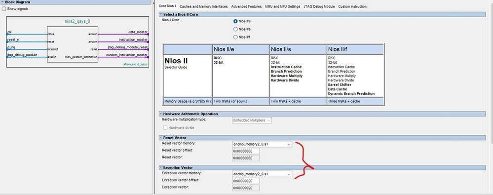

Check the reset vectors in the NIOS 2 IP. If the reset vector points to uninitialized memory then you get these kinds of errors. I also have much less errors using the command line instead of the Eclipse tools GUI.
- akaanb
I didn't use ddr2 mem as reset vector or exception vector since I am going to test it. These are the configurations. I was going to say it at the beggining but I forgot while openning to topic.

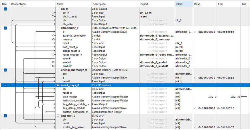

Also here is the proper qsys image. It seems like the first image is hard to understand.- Jacob11
I haven't used this DDR memory IP, but in all of my designs everything runs directly from the clk_0 instead of this sysclock output from the DDR. Maybe try connecting the clk directly to each IP. Other than that I am not sure.

When I don't include altmemphy DDR2 IP in my design, I can create Small Hello World or any other application and it works. I see the "Hello world from Nios II!" at the nios console in eclipse. Same reset signal, clk32 as clock, same jtag uart, same on-chip ram.
When I use DDR2 IP, I feed clk32 to the DDR2 IP. And it gives sysclk clock to prevent from metastability and cdc issues. So My system works with 62.5 sysclk. But nothing work. So either the system in reset or the ip in reset and doesn't give clock. I gave fixed '1' in top module since it is an active low reset and nothing changed. I changed it to '0' and nothing changed. I tried to do the same thing with sopcbuilder since it connects reset signals itself and nothing changed.
I checked the external clock and reset circuit. It is ok. Simple push button reset that connects the pin to the ground when clicked. Otherwise pulled-up to 3.3V. Clock signal is fixed 32.768 Mhz.

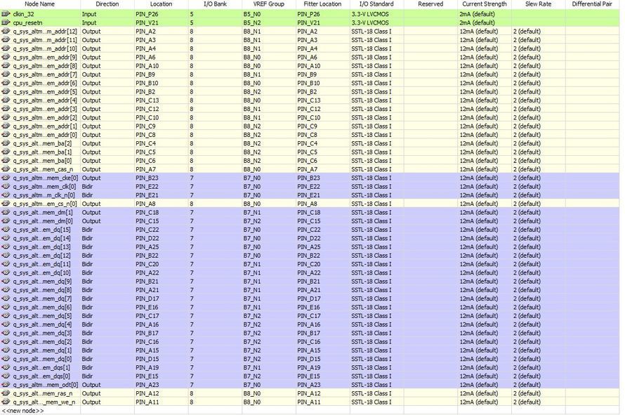

I share my pin assignments because there must be something that causes the IP to behave like that. I also share my top module.
