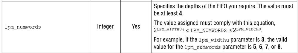

For lpm_numwords=32, I set lpm_widthu to be 6. Nevertheless for 32 depths, I get a compilation error telling me lpm_widthu has to be 5.
101 digital electronics: 2^5=32, the values can go from 0 to 31, how a 5b word can represent the number 32?
Documentation from September 2010 Altera Corporation SCFIFO and DCFIFO Megafunctions:
Am I missing something?

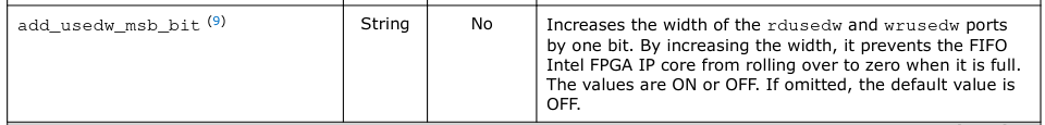

  • I'm just going by what I think is the most recent version of the guide:
    https://www.intel.com/content/www/us/en/docs/programmable/683522/18-0/fifo-user-guide.html
    Looking through it, I see the add_usedw_msb_bit option, which might be what you're looking for to see the correct value on rdusedw and wrusedw.
    I don't know why the read side is showing empty when wrfull indicates it's full (which is strange), but check out the latest version of the guide and see if that helps. You're looking at a 12 year old version of the doc.

      Good catch, indeed I used an old documentation because the formula isn't present in the new one.
      It's just crazy that it rolls over to zero per design... I really thought we were done with such mistakes after the Ariane 5 rocket crash due to an overflow.
      Fascinating, instead of fixing the IP for good and make it consistent, let's add a parameter as a workaround.
      Thanks!
      edit:
      Actually the lpm_numwords' formula was changed in the new one, it's even more restrictive:
      The value assigned must comply to the following equation: 2^LPM_WIDTHU

    The document you posted says the upper limit must be less than or equal to, not just less than. Maybe you missed that? So with lpm_widthu = 5, lpm_numwords must be greater than 16 and less than or equal to 32.
  • Thank you for your answer.
    and less than or equal to 32 I set lpm_numwords value to 32. You agree that I did nothing out of specs, thank you for the confirmation.
    Coming back to my question: how a 5b word can represent the number 32? (as you also wrote, 32 is a correct value for lpm_numwords and lpm_widthu=5)

  • You must be kidding... add_usedw_msb_bit is only available on DCFIFO.
    How on earth this could not be applicable to the SCFIFO too?! Seriously?!
