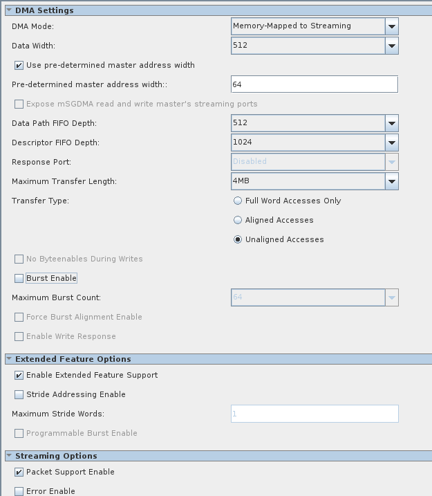

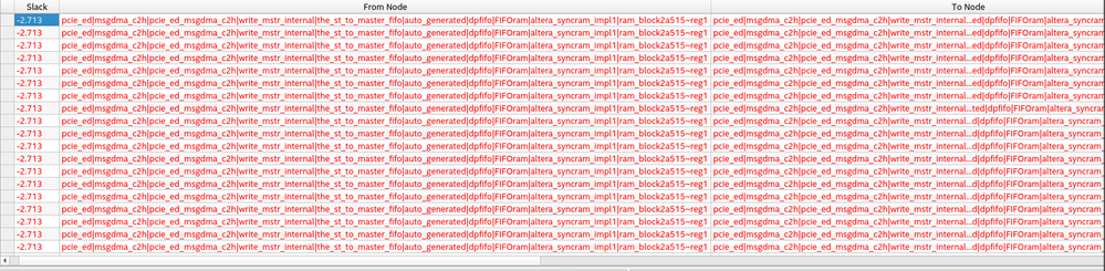

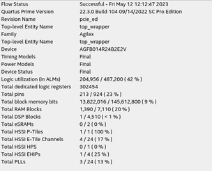

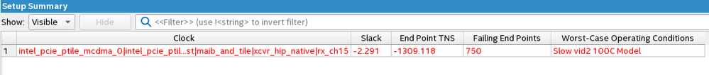

I have a design based on AGFB014R24B2E2V FPGA device. This design implements a simple general NIC functionality and PCIe for connection to the host. Design is clocked by PCIe user clock and it is 250 MHz. I use two MSGDMA IPs core for moving data to and from host memory (one for stream to MM translation and one for MM to stream). The problem is that according to timing report there are a plenty (~60k) of failing paths in MSGDMA IP. I've attached a piece of timing report and utilization report below.
So my question is are there any ways to fix those timing issues? I couldn't find any performance data for this IP so I cant even learn whether I can use it in my design or not.
