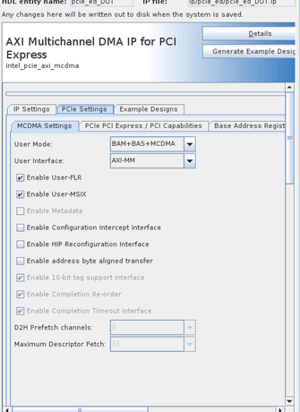

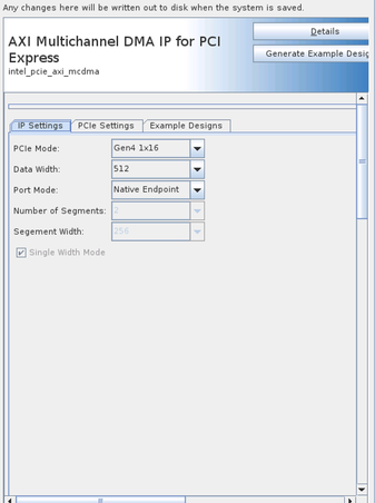

    1. Could you attach the AXI MCDMA .ip file so we can review the parameter settings?
    I will attach an archive with the whole subsystem we use
    1. Which design example variant and which driver did you use?
    Unfortunately I don't remember what particular example design we used. We use our own driver for our device, but it does nothing with PCIe itself.
