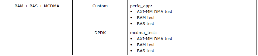

My understanding is that you ran the AXI-MM DMA Example Design application, either perfq_app or mcdma_test, using the provided driver, either Custom or DPDK. When running the application, you observed the failure: Writing 449 bytes to BAS, the host hang and subsequently reset.
See Table 57 in the user guide for the application and supported test: https://docs.altera.com/r/docs/817911/25.3.1/axi-multichannel-dma-ip-for-pci-express-user-guide/design-example-overview
