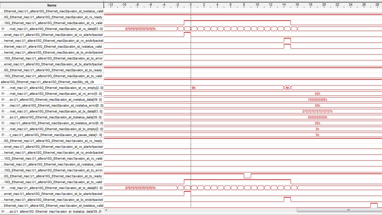

Hi All,
Does anybody know why avalon_st_tx_ready de-asserted in the middle of the packet transfer? Attached a capture of signal tap. I can see a missing data on the pc that receive this packet. the missing data is correlated with data transmitted while avalon_st_tx_ready de-asserted. Thanks12 Replies

That means the receiver cannot receive the data. If the data isn't held during this period then it will be lost.

The data is transfered to the PC.
Do you mean there is a problem with the PC's 10G card? - Altera_Forum

What is the ready latency parameter on the ethernet IP core?

I am sending a 124Byte packet every 10 sec. I don't see how it can be a latency problem.
What do you mean by pointing ready latency parameter? ( "The ready latency on these interfaces is 0 and the MACexpects the empty signal to contain a valid value."----10-Gbps Ethernet MAC MegaCore Function User Guide----page 7-4) - Altera_Forum

If the ready latency = 0, what does the data change when ready is low?
The length of the package from the (very low resolution) picture you sent appears to show 15 transactions, when a 124 byte package would require 16 transactions with tx_empty set when end of packet is asserted. Please post a better picture with more signals Next question - did you simulate this design before putting it in the FPGA? - Altera_Forum

Without the code in the FPGA design, I dont know what you want me to do.
The FPGA appears to be not working properly. - Altera_Forum

does anybody else has an idea what can be the problem.?????
-- The problem can be seen also in simulation - Altera_Forum

If the problem is also in simulation, then it is clearly a problem with the fpga logic that generates the packets

In Signal Tap : the packets are transmited by an external PC (was validate and works fine).
In simuation : the same packets are transmited by a test bench. The fpga logic is ALTERA's IPs (MAC & PHY). no logic was added. Do you think altera has problem with this IP?
