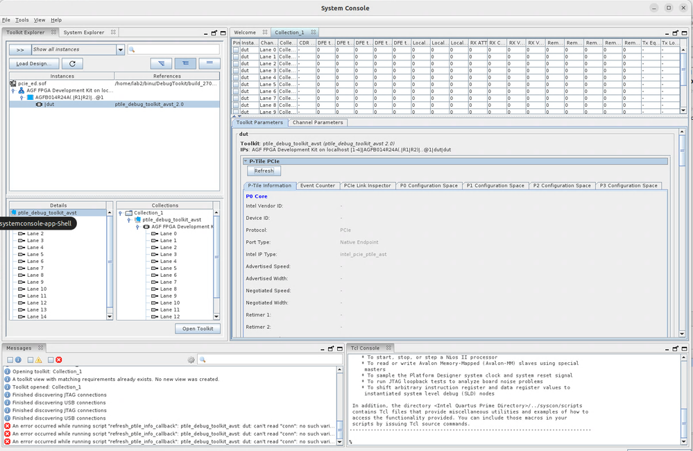

I got the DebugTool kit with the above changes/as mentioned in P-tile Debug tool kit using Quartus 23.4. But I get some errors on the System Controller interface. Screenshot below for reference.
Any input on this is much appreciated!

- Screenshot of System console/Debug tool kit interface showing no link layer information populated eventhough design is loaded. This was previously provided in this thread. But attaching again.
- Below is text of error message:
ptile_debug_toolkit_avst: dut
SEVERE: An error occurred while running script "refresh_ptile_info_callback
": ptile_debug_toolkit_avst: dut: can't read "conn": no such variable
while executing
"puts -nonewline $conn $json_cmd_msg"
(procedure "ptile_pcie_pysv_pkg::send_msg" line 5)
invoked from within
"ptile_pcie_pysv_pkg::send_msg $opDict"
(procedure "read_reg" line 3)
invoked from within
"read_reg "${pcie_path}.device_id_vendor_id_reg.pci_type0_vendor_id""
(procedure "ptile_pcie_driver_pkg::get_ptile_info" line 5)
invoked from within
"ptile_pcie_driver_pkg::get_ptile_info $i"
(procedure "refresh_ptile_info_callback" line 12)
invoked from within
Binu
