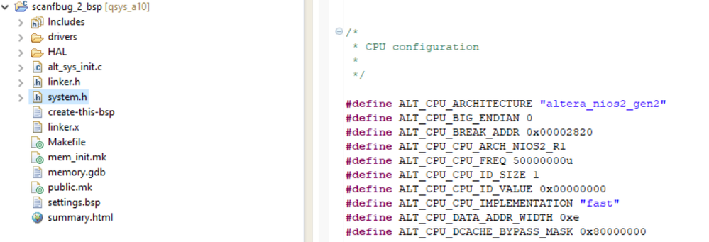

      For the previous explanation, this was the <ProjectName>_bsp directory and system.h file that I mentioned as you create a file on Eclipse.
      and you should be able to see the fast/economy version using.
      Kelly Jialin, GOH

  • KellyJialin_Goh's avatar
    KellyJialin_Goh
    The NIOS II system description header file, system.h contains the software definitions, name, locations, base addresses and settings for all the components in the NIOS II hardware system.
    It should be located in your <ProjectName>_bsp directory and you shall see the system.h file.
    Open it with a notepad and locate to the CPU configuration and you will see the
    #define NIOS2_CPU_IMPLEMENTATION "fast/economic"
