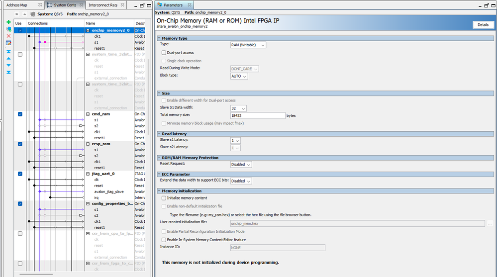

The settings for the RAM-IP are as shown in the image below:

        Are the on‑chip memory configuration settings the same in both Project 1 and Project 2?
        Are there any differences in the Analysis & Synthesis or Fitter settings?
