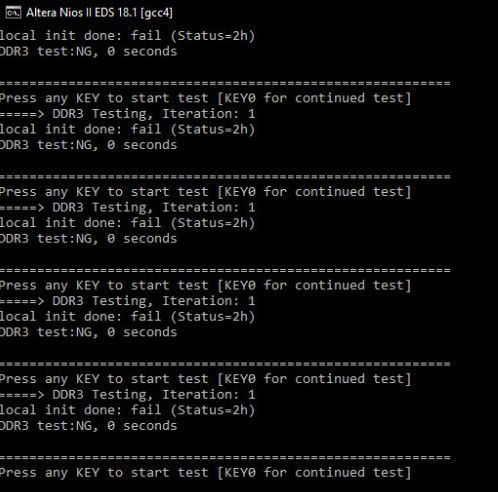

local_cal_fail is assert when running DDR3 SDRAM Test by Nios II example on Sockit Rev D board
I have a problem relate to DDR3 interface when running DDR3 SDRAM Test by Nios II, local_init_done is asserted. I tried to debug and search information but there is no more information. Can you help me to solve it?

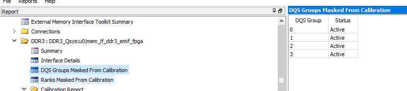

I am using Sockit Arrow board rev D (Terasic - SoC Platform - Cyclone - SoCKit - the Development Kit for New SoC Device) with Cyclone V(5CSXFC6D6F31C6N), DDR3 chip is IS43TR16256A (issi.com/WW/pdf/43-46TR16256A-85120AL.pdf).

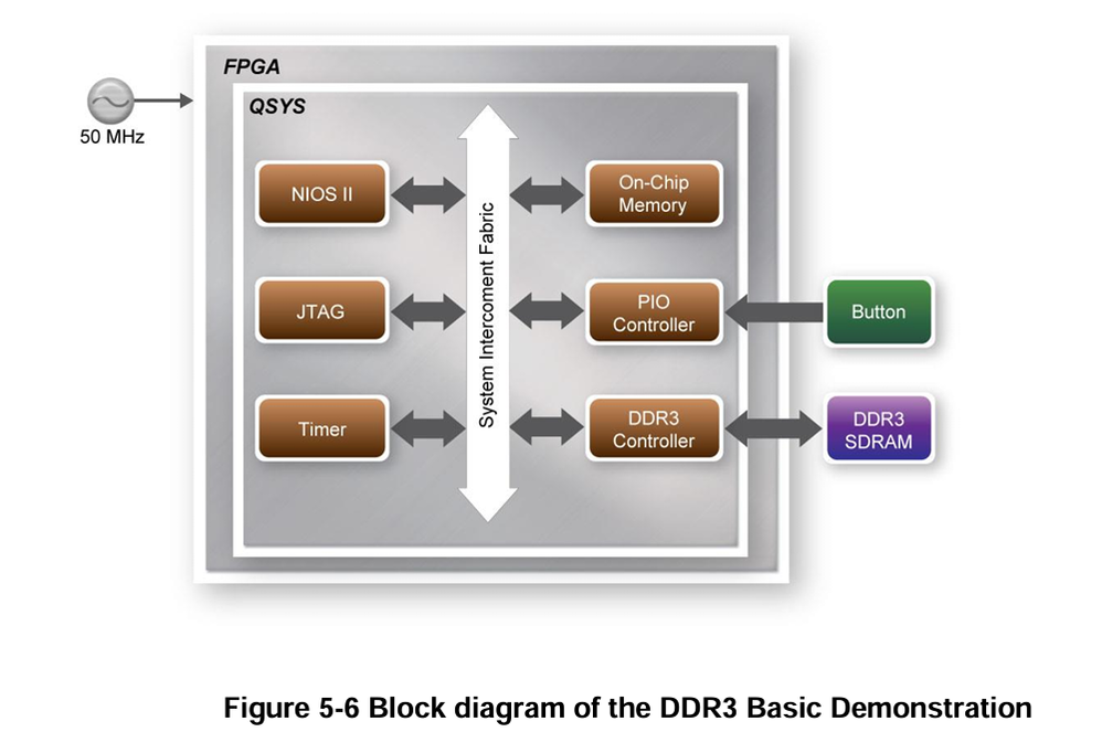

I programmed the .sof file through Demonstration Batch File in SoCKit_DDR3_Nios_Test example, and problem was happened. The architecture of example is below:

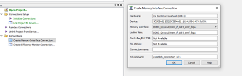

I tried to run EMIF toolkit (in Quartus 13.1), the memory connection is:

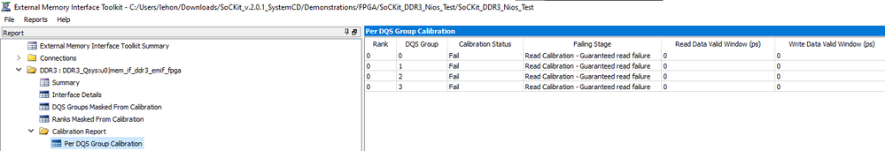

The summary report:

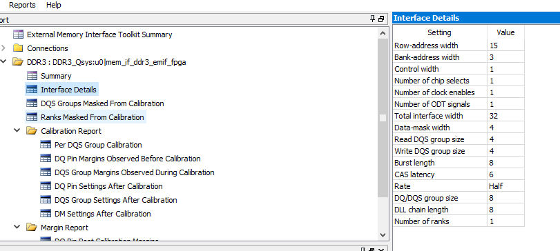

Interface details:
DQS group masked

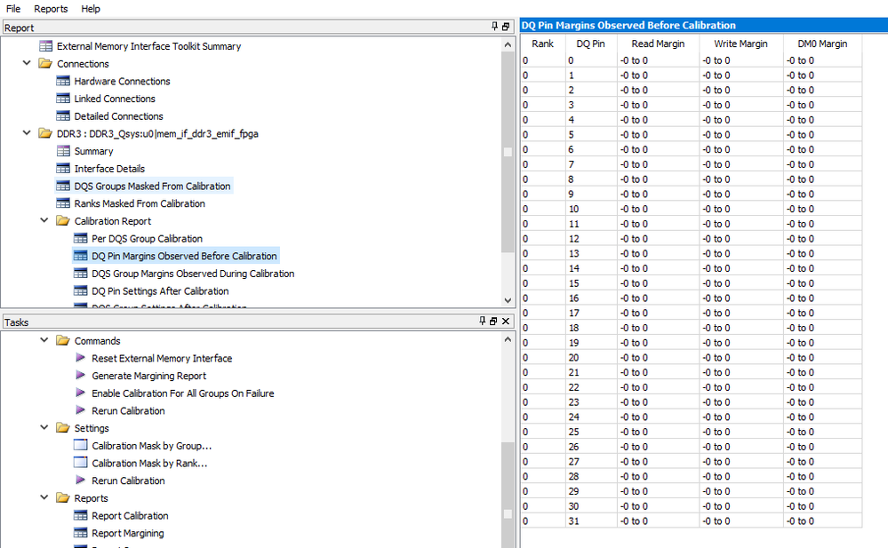

DQS group calibration
DQ Pins margin before, during and after calibration are 0
