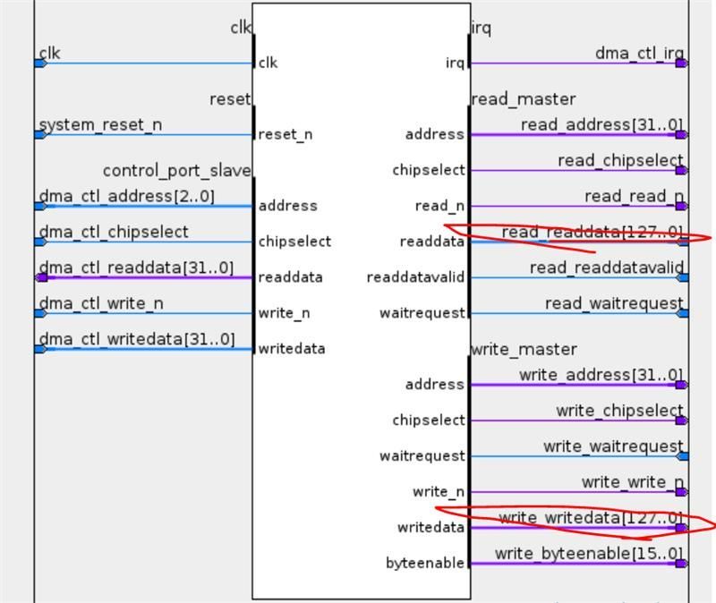

Long time ago, I successfully changed it to 128bit and there is also a byte enable signal in write port.
Thanks!

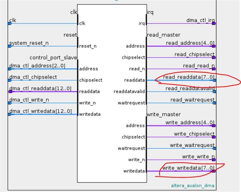

    i discoursed with engineering team every one, telling we don't have option to vary the data width of DMA. i shared your platform design also, they telling you did changes in source code. Actually we are not able to give support for source code changing. if any problem is there in working of IP we can give support. sorry.

    Small doubt, in you previous DMA (128 bit support IP) can able to trans for 128 bits, because this ip design can support only 8 bit's only. did checked that?
    Thank you,
    • Jiayi_H_Intel's avatar
      Jiayi_H_Intel
      Yes. It can transfer 128bits and worked perfectly well. I have also tested it on FPGA board.
      You can double check with the IP I sent to you.

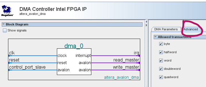

    • Byte (8-bit), halfword (16-bit), word (32-bit), doubleword (64-bit) or quadword (128-bit)
    those are transfer type, there is no option to change width.

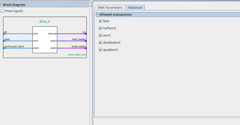

      You can see my snapshot, I have already enabled quadword, but readdata is still 8 bit.
      I am using Quartus 21.3 and 21.4.
      BTW, you can check the "show signals" box in your picture to see the signal width. Is it a 128bit width?

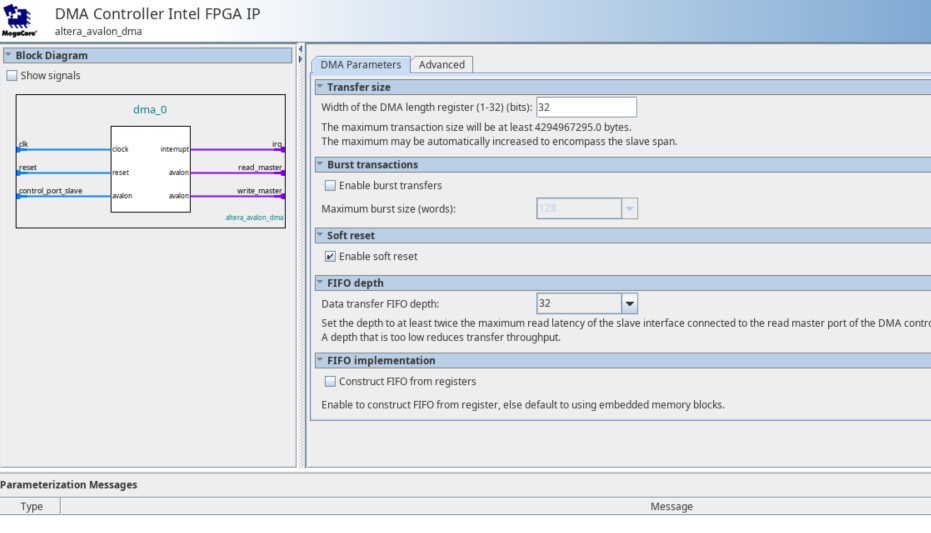

      But there nowhere to change it in parameter editor:
      BTW, I am not using blackbox.
