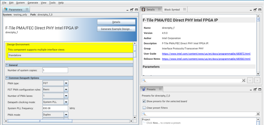

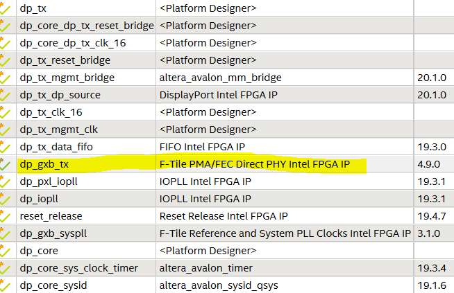

I have generated the reference design for display port IP with help of user guide " F-Tile DisplayPort Intel® FPGA IP Design Example User Guide" version 20.0.1.
The reference design having F tile PMA/FEC Direct Phy Intel FPGA IP.
on analyzing the reference design IP instance file the interface port signals are different from the interface signals for the same IP from the IP catalog.
does the reference design using any other customized transceiver IP which is not listed in IP catalog?

No, it is not a customized transceiver IP. The design example uses the F-Tile PMA/FEC Direct PHY Intel FPGA IP, which you can find in the IP Catalog.
For more information about the F-Tile PMA/FEC Direct PHY Intel FPGA IP, please refer to the User Guide: https://www.intel.com/content/www/us/en/docs/programmable/683872/24-2-4-9-0/f-tile-overview.html
