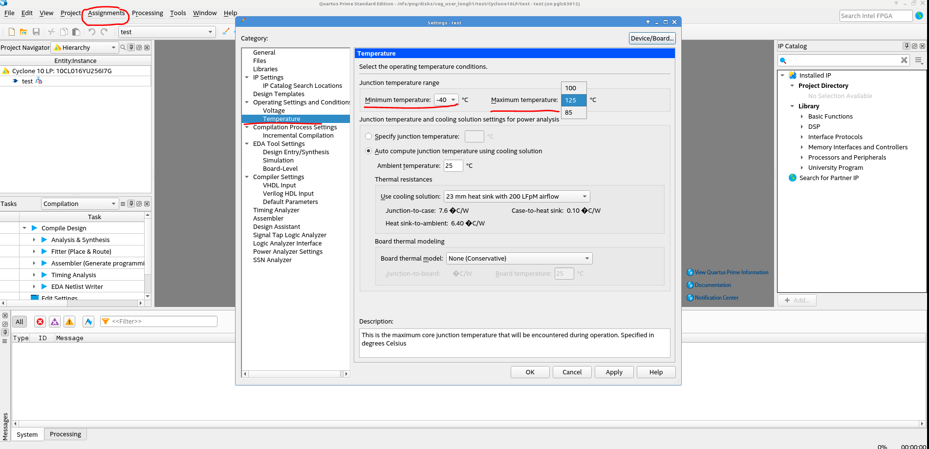

    3. After selecting the device, if the device is supported for Extended Industrial grade, you may check it on Assignments - > Settings -> Temperature. This is the example for 21.1 Standard version:
     I checked with the latest Quartus Standard Edition v25.1, but I could not set it to +125degC.
    According to my colleague, if there is no .ini file in the past, it will not be enable.
    Would you please check whether special .ini file is needed?

    1. Refers to this KDB, it mentions that there is no difference between Industrial and Extended Industrial in device OPN. Both will be used "I" as the letter to indicate the Operating Temperature.
    2. If the device OPN is listed as Extended Industrial grade, then you may choose the same OPN in EPE.
