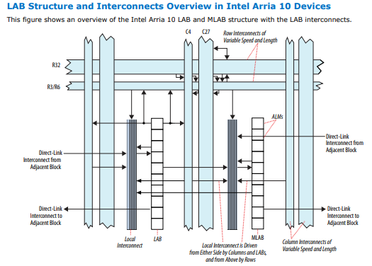

I am working with an Attila board on which is installed an Arria 10 FPGA component. In the Arria 10 handbook, there is a diagram of the LAB structure which is atteched below. I want to know what do R32, R3/R6, C4 and C27 refer to.

Hi Lotfi, C and R is actually the interconnect that connects to the internal component of the FPGA. Regards, YL - sstrell
C: column, R: row
The number specifies how many device resource blocks (LABs, memory, or DSP) the wire route spans. Longer wires are usually more limited and their overuse can lead to congestion issues. You can highlight wire usage for your design using a report in the Chip Planner. The report generates a heat map so you can see where there are "hotspots" of the overuse of certain wire types.

This is is the block diagram of a LAB in ARRIA 10 FPGA.

Thank you for your reply. Actually, what I want to know is the meaning of values after the C or R letter. When I read the handbook of Cyclone5 or Cyclone 10 GX FPGA, I find approximately the same diagram. The difference is in the incterconnect. For example:
- Arria 10 : C4, C27
- Cyclone 5 : C2/C4, C12
- Stratix 10 : C2/C3/C4, C16
So, are these values related to the interconnects technology, speed or width...?

When I have checked "Lab diagrams" of each FPGA, I noticed that there is a difference in the routing architecture:
- Arria 10 and Cyclone 10 GX : C4, C27, R3/R3, R32
- Stratix 10 : C2/C3/C4, C16, R2/R4/R10, R24
- Cyclone 5 : C2/C4, C12, R3/R6, R14
So do you think that the length of wires can have a negatif effect on the maximum frequency of a project design on FPGA?
