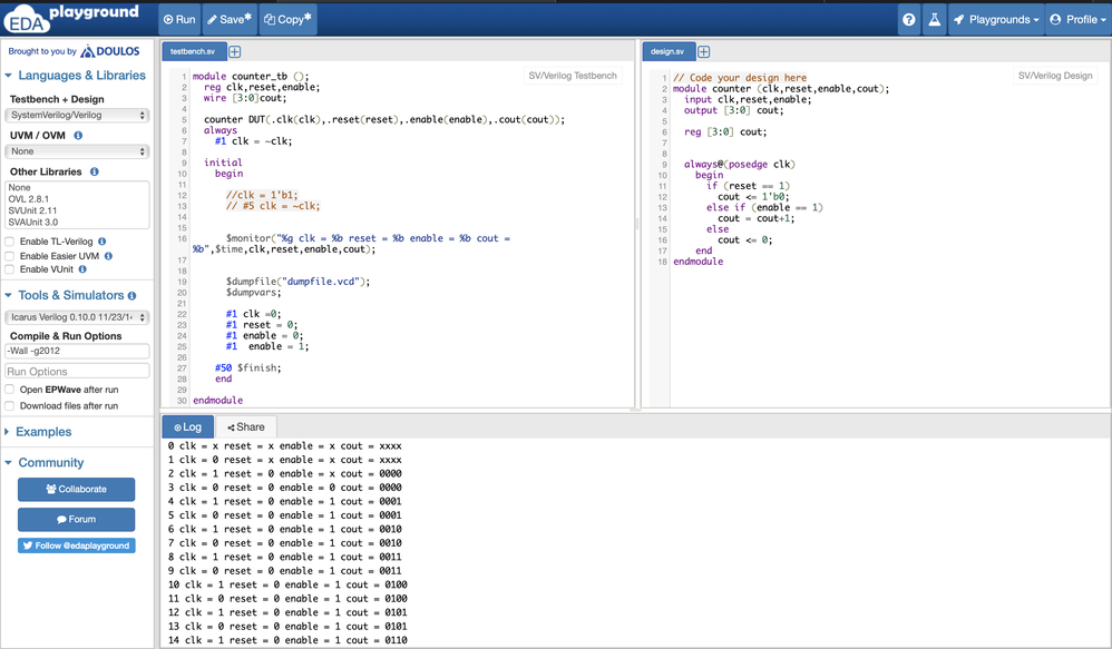

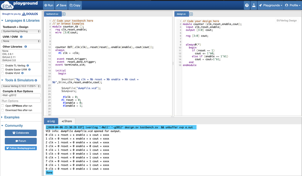

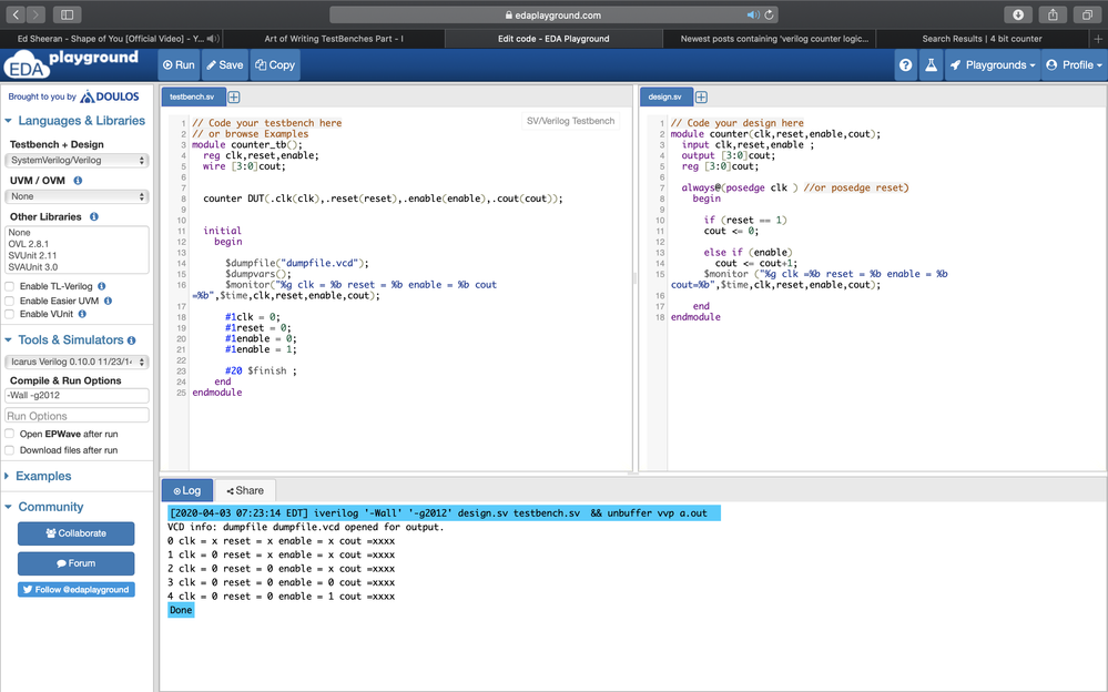

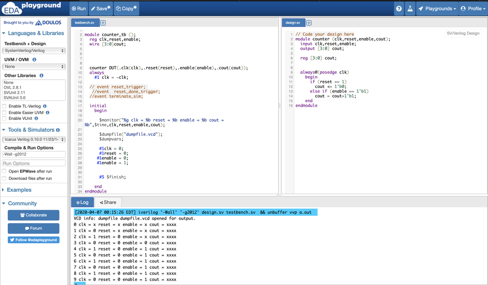

I am writting the Verilog code and test bench for 4 bit shync up counter but I am not getting the desired output my code is below I should get cout as increased by 1 but I am not getting it when enable is high.

    Your testbench is not toggling the clock, so nothing is going to happen.

    still I am facing the same problem tough my test bench clk toggling now....
  • sstrell's avatar
    sstrell
    You changed your always block so it is no longer clocked. Put it back to always @(posedge clk).

  • sstrell's avatar
    sstrell
    I'm not familiar with this simulation tool, but perhaps you have to initialize or reset cout to a value instead of xxxx.
    #iwork4intel
  • ASing173's avatar
    ASing173
    its online tool edaplayground (icarus Verilog 0.10.0)
    count depends on the inputs given i.e the reset and enable and I am giving both logic so according to that logic the output should be produced...
