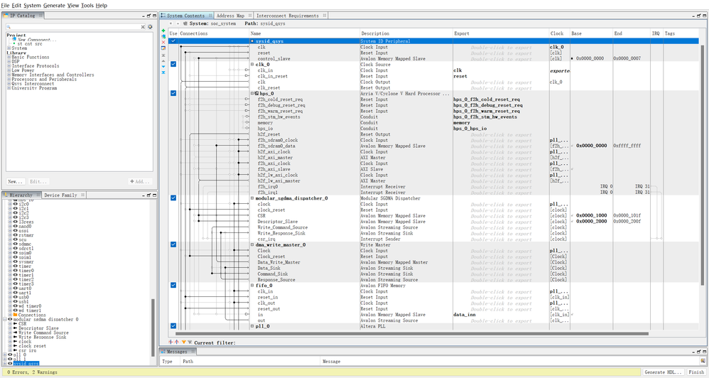

      Thanks for your help. I have referred to writing_to_hps_memory and made modifications to my design. As you said, I used F2H_ SDRAM bus, but my confusion is how to control mSGDMA to transfer data into HPS DDR through the F2H_SDRAM bus. In writing_to_hps_memory ,control mSGDMA by writing a program on the HPS side. However, I need to write a program on the HPS side to send data from HPS DDR. Therefore, I want to add a nios II in qsys (platform designer) to control mSGDMA for data transmission. I don't know if this is feasible.
