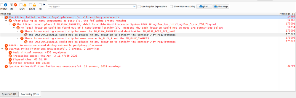

I have tried using the example design of the A5ED065BB32AE4SR0 development kit and modified the part number to A5ED043AB23AI2V.
During compilation, I am encountering a fitter error when both PCIe and USB 3.1 are enabled together. However, I am able to compile successfully when using each interface individually.
Could you please help me understand how to resolve this issue?

    Are you putting PCIe and USB3.1 on the same bank? using one XCVR?
    Do they share the same clock source?
    Rong
  • hi,
    Pcie using  4A,4B,4C banks.
    USB3.1 bank is 1C,5A bank. for this A5ED043AB23AI2V , 12 XCVR  are available.
    can you please hlep me to ressolve the fitter error

      Pls share you pin assignments for check.
      Rong
  • Hi,
    Thank you for your reply.
    I am trying to use the same pin assignment as the DEV KIT A5ED065BB32AE4SR0 design. However, while compiling for the A5ED043AB23AI2V package, I am getting fitter errors.
    Could you please help us resolve the compilation issue, or alternatively provide a compiled QAR file for enabling PCIe Gen4 + USB3.1 support in the A5ED043AB23AI2V package?
    Waiting for your prompt response.
