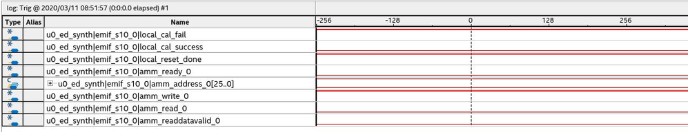

I am using the qts_hilo_ddr4_x72_1066MHz sample project to test the DDR4 HILO in the Stratix 10 MX development kit. I didn't change anything, except upgrading the project from Quartus 18.1 to Quartus 19.4.
After downloading the SOF file in the board, I used SignalTap to observe the signals and realized that DDR4 HILO controller module always returned local_cal_fail = 1.

When you run project from Quartus 18.1, do you facing similar issue?
Can you please check on the PLL signal? I suspect the PLL loses lock and this will assert the reset signal until the PLL is locked. The reset signal need to de-assert in order for the controller being enable. Kindly, please check on this two signals.

Thank you for your quick reply.
I also built the sample project in Quartus Pro 18.1 and got the same problem.
I'm not sure which PLL signal you mentioned as I didn't change anything in the sample project.
You can see the reset_n = 1 with local_reset_done = 1 in the SignalTap
Also, no timing violation was reported in TimeQuest.
Please let me know how I can fix it.
