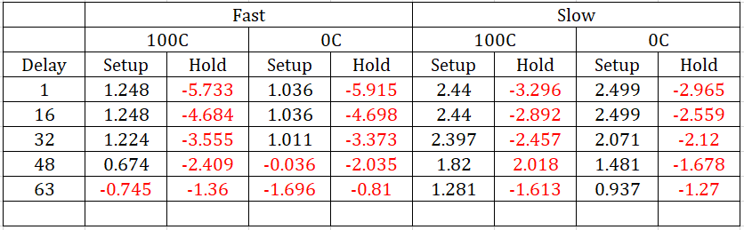

This is one time run result. I use PLL phase in SDC file to adjust the timing result, but never succed. Hold time even is larger than 3.571ns(280MHz). I don't know how to satisfy the timing . Is there anything else i forget to do with my SDC file?
- ljian50
If DDIO sample with the input clock from pin, and I change the data time delay from pin to DDIO input use INPUT_DELAY_CHAIN in .QSF file, hold time is never satisfied. The result is below
