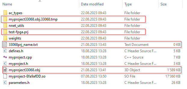

I finally managed to get my HLS compiler working and already successfully compiled one of the example projects. So I gave it a try with my own design. First it looked good. The compiler started to build up the file structure in my folder:

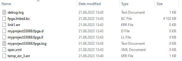

Also inside the project folder it started to create the files:
But after the compiler was still working after 10 minutes, I checked the folders again if something happened. The files still looked the same! So I thought maybe I'm just impatient and let it run over lunch. Even after 3 hours, the compiler still did not finish and also the files in the folders did not change. So I decided to stop and repeat it. Still the same. The compiler stays in the following condition for hours:

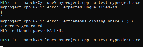

    During my first attempt with the HLS compiler, it still claimed an issue with the braces. The compiler this time printed the error message and stopped working.
    I was not sure if the HLS compiler got confused by the #ifndef statements in the myproject.cpp file, because the claimed braces were placed within these #ifndef statements. Therefore, I did remove them completely because they are not necessarily needed for a first test run. After that the HLS compiler started to work. But I ended up in the same situation as before: The HLS compiler runs forever without returning any message.
