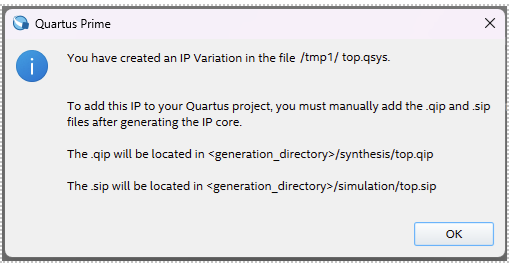

To work around this problem in the Quartus® Prime Standard Edition Software version 25.1,
  1. Remove the QSYS file from the project using the Remove Files in Project function.
  1. Add the QIP file to the project using the Add Files in Project function.
