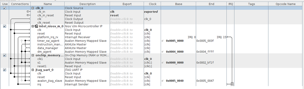

NIOS V Sysnthesis Fails with Quartus 25.1 Lite
I used Quartus 23.1 Lite for a couple of months and have now switched to Quartus 25.1 Lite. Since the version update my NIOS V Plattform Designer Projects do not synthesize any longer.
Synthesis fails with:

I am using the DE10-Lite Board with the Golden Top example Design and add a very basic Nios V to it.
//  Structural coding
    niosv u0 (
        .clk_clk       (MAX10_CLK1_50),       //   clk.clk
        .reset_reset_n (1'b1)  // reset.reset_n
Any idead how I can fix that Issue?

    Assuming you are just bringing the old .qsys file into 25.1, have you tried manually regenerating the system first before compiling in Quartus?  Did you get a warning/error about updating the Nios V IP for the newer version of the tool?  If not (or if you did and you didn't update the IP), you should still try deleting the Nios V and then re-adding it to your system and then regenerating the system.
  • SimonT's avatar
    SimonT
    The .qsys file was created completly from scratch with Platfrom Designer 25.1.
    There are some standard warnings, but nothing unexpected.
