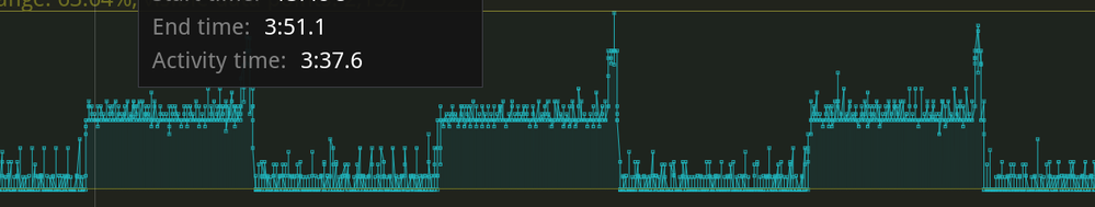

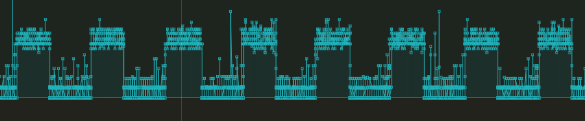

However there is a strange CPU anomaly when starting this simple irq handling program:
  • There are ~5 sec long spikes in CPU usage every minute, periodically
  • When I reduce the number of interrupts coming from the FPGA to 25, the 1 minute period doubles to 2 minutes.
  • When stopping the FPGA to send interrupts, and waiting some time (for eg. 1 minute), then resuming again, the priodicity of the spikes continues from the last state when the FPGA generated interrupts. So when pausing the interrupts in the midde of a spike for some minutes (the cpu usage goes to ~0%), after the resume, the CPU usage continues from the middle of the spike.
  • The characteristics of the CPU usage graph can be tuned by doing work between the waiting for the interrupts, so the spikes can transform into a wave:
// Do IRQ
    while (true) {
        //Doing some work
        volatile double x = 0.0001;
        for (int i = 0; i < 20000; ++i) {
            x += std::sin(x) * std::cos(x);
        auto status = wait_for_irq(tx_irq_handle);
Here are some pictures:
Doing no additional work:
Doing some work:Doing little work
Doing more work:
Doing more work
