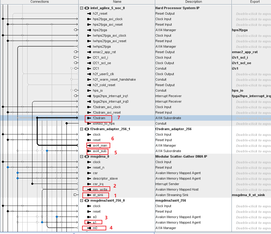

    Hello, I am also currently working on MSGDMA development. I have successfully established access to the MSGDMA CSR and Descriptor registers via the LWH2F bridge using devmem2. My setup is configured in Streaming-to-Memory-Mapped (ST-to-MM) mode, similar to yours.
    I have two specific questions regarding the implementation:
    1、Is configuring the standard Linux kernel driver a mandatory prerequisite for the MSGDMA to function correctly, or can it operate independently?
    2、I noticed that you are writing to the PS-side memory via the FPGA-to-HPS bridge. However, my design utilizes the F2SDRAM (FPGA-to-SDRAM) interface path, as indicated by the numbered sequence in the attached diagram. Could you please confirm if this architectural approach is feasible?
