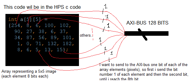

My plan is, for example if i have a 5x5 image in C, i want to send 1 bit of each element/pixel from the HPS to the fpga every single cycle ( of course we need handshaking between the fpga and the hps in that case), and then after a number of cycles i want to also receive the data bit by bit and store them into an array as integers.
The de1soc has an heavyweight AXI-bus which can send 128bits at once.
so i was thinking if its possible to send 128 bits to my design ( which each bit of the 128 is actually 1 bit of an 8bit pixel, so in other words ill be sending 1 bit from each of the 128 pixels (8times), and then receive them the same way 1 bit at a time and store them in a new array).

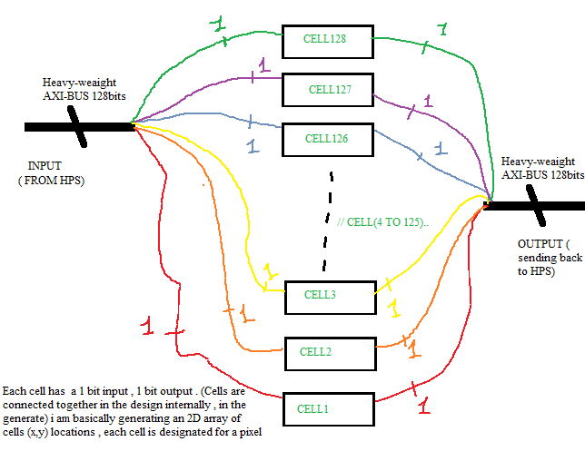

I think, my explanation in the thread was not really clear. Sorry, I don't have that huge experience with FPGA's so I am going to explain what I want to do using some sketches I made.
Okay so in the following sketch as you can see;
I want to use the full power of the heavy-weight* AXI-BUS (128bits). Basically ill be sending 128 bits to my design, but each bit of the 128 is going to be sent to a cell of the 128 cells.
The cell I made is serial so it has 1-bit I/O's (includes shift registers and other extc).
ill be sending to each cell a pixel (8-bits), so i will be repeating the process i made below 8 times. in order to fill the reg in the cell.
ill be doing it as the following: 1 bit at once to assure speed and efficiency.
